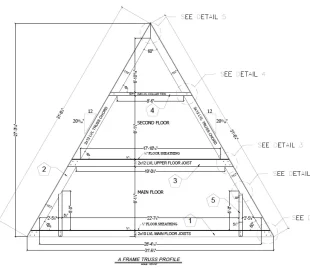

Piping wood stove up through A-frame great room. Center or off to the side? Pros and cons?
kingbuzzie
Jan 22, 2018
5
Austin, TX
We have are a-frame house framed up. We had originally planned to have to patio doors on the front spaced about 3 feet apart with a wood stove in the middle. The stovepipe would run up the front gable wall of the a-frame and out just to the side of the peak. That is option 1. The other option is to put a large 3 panel patio door in the center and have the wood stove off to the side. This means running the chimney outside. I have read the interior stovepipe is more efficient. Which setup is cheaper. Also it is a 60 degree triangle, I'm not sure how high I would have to run it up outside for code. I personally thought the look of the stovepipe running up the wall of the great room would look nice. Also, if building a storm proof structure, is having a high external chimney going to make it more prone to wind damage?
I must add we live in north Georgia, so the wood stove is more for fun and backup than primary heating. Thanks for any input!

Center the stove and have 45 degree elbows near the ceiling to offset off of centerline of roof. I’d choose the side that is least visible. From the outside driving up. If it’s at the top I doubt prevailing wind direction would make much difference. But that might be question for an expert.

The roof pitch will mean a fairly tall exterior stack if it exits low. Interior stove pipe is less expensive so it will be less expensive to do as EbS-P suggests, and the flue should work better. Given the tall stovepipe inside, it should be double-walled (DuraVent DVL, Selkirk DSP, etc)
This is the 10-3-2 rule that governs chimney height in relation to the roof.
