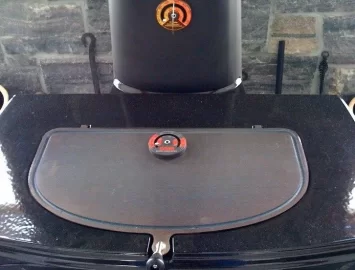

Yes, two thermometers are an advantage. I use one on the middle of the stove firebox, the Encore griddle, and one about 10 inches up the flue. I first verify each individually for correct reading, then periodically compare them together for accuracy on the same surface.
See the photo.
