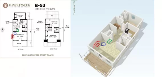

Ok, so thinking about the placement of the stove in the tiny home. If this was a single story home like some I've seen with a large great-room, I would love to put it right in the middle. But with this smaller home being 2 story, it's got to get 'put' somewhere. Check out these 3 locations.
Red would be the little stone or brick 'alcove' to add space onto the floor plan just for the heater. Pros- more space to move. Con - heat is close to the wall and might not flow well for the house. Solution? Blower motor for the stove? A good ceiling fan for that room? Whole house fan/return nearby?
Blue could be in that corner. Either angled or put in @ 90*. I like this option the least.
Green would alter the plans by taking out that hall closet and putting the stove in underneath the stairs. I actually like this one the best. The heat can rise easily to the second floor, it's closer to the back of the house for that 3rd bedroom and kitchen, and it's out of the way. Maybe in the corner where the blue marker is we could put a coat rack, wardrobe, armoire, whatever.
Thoughts?
