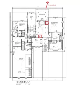

Stove Spot #1:
Pros:
Closer to spot of wood entry
Potential ugly(in my wifes eyes) silver stove pipe hidden on backside of roof
Cons:
Non-central heat location
May be too hot in our Master bedroom
Stove Spot #2:
Pros:
-More central in the house
Cons:

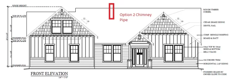

-Potential ugly(in my wifes eyes) silver stove pipe on the front of my house. Can I make this look nicer somehow?
-Longer path through house carrying dirty wood

I like loc #2 but not the way it is shown. Is there a low flat roof in the center all the way back through the great room or is the elevation drawing missing something?

Oops I didn’t see the second pic.
The chimney pipe can be chased to hide it and the chase can be clad to match the house siding, or with faux brick.
If it’s a flat roof it will look ugly no matter what you gone do with it.
It is not a flat roof you are just looking at the face of the roof there

I say option #1. Doesn't seem that there would be a whole lot of difference heat wise since both locations are in the same room. Meanwhile besides hiding the stove pipe and being closer to the wood supply it looks like #2 might inhibit foot traffic whereas #1 is tucked away with room for wood supply, tools etc.
We will have a flat 9 foot ceiling height in the entire house. The roof is pitch at 8/12 in the main room which peaks 6-7 feet in from the den wall where location #2 is shown.
Thanks for the info. I knew it could be done, just couldnt come up with the right description for the google search. *Chased* chimney pipe in google will help come with ideas of how to make this fit with the finish of the house.

More over it appears as though the stove is pretty much in the same room . . . I suspect making it a little more central might help, but what might also be even more beneficial is in how the stove is positioned in the room (i.e. angled installation vs. parallel to the wall) and how you plan to move the heat.

Option 2 will be much better for heat circulation into the master bedroom and through the kitchen. You will have trouble getting heat into the smaller bedrooms no matter what.
That said, I foresee significant issues with bringing firewood through the back door, around all the furniture, and then up to that location. I know I would personally choose option 1 for that issue alone.
Option 2 appears to be close enough to the ridge line that it should be possible to offset the flue to exit on the back side of the house. You will still want a chase for appearances.
Option 1 appears to have a clearance issue with the door. Perhaps the doorway could be offset a bit, or perhaps narrowed? Or both?
Either option is going to provide a surprising amount of heat to the kitchen while the nook, with two exposed walls, may be uncomfortably cold by comparison. I would strongly suggest insulating window treatments in that area.

Thanks for the replies. The house design is permanent. If I had more money, I would’ve designed a house around centralized masonry heater. I like that option 1 is so close to the point of wood entry. I think having less debris scattered throughout the house from hauling loads will ultimately net me less work and complaining long term. This factor holds a lot of weight here. I will definitely have to think about clearance to hearth with the French door. I will likely post and ask questions on my endeavor as this all comes together over the next year(s).

Ok, agree with using a sling. In my last setup, I had the stove right next to my back door, so I was too lazy and cheap(and stupid) to think a sling would help. My arms became the sling and I wasnt always the best at being clean with this. The sling definitely makes spot 2 more attractive. My truss locations are also a consideration for me as they would not accomodate a corner install in spot 1. There is a truss is 24" out from the MBr wall which would conflict with a straight and preferable stove pipe exit. The stove pipe at spot 2 would line up pretty perfectly with the truss locations.

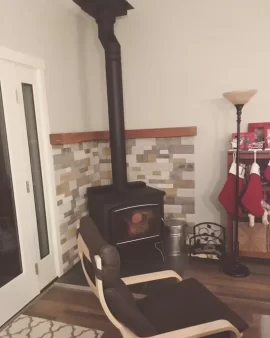

Looks nice. Great stove. Guess I didn't realize it was available with the Accents? Interesting. Here's to overnights..... And beyond;lol
