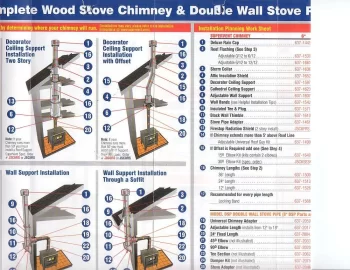

The "correct" set up doing it your self is going to cost from $350-$750. and having it done is going to run from $600-$1400. + depending on your application .
Posted is a chart to get you started and what your going to need.
  • [Hearth.com] Please dont let me burn down my garage
