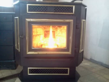

Please help identify this pellet stove....
krazyrat
Mar 6, 2014
3
western,Ny

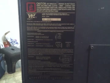

The back of the pellet stove only has one big label that shows it was tested by WH and under it, Franklin products Mexico,MO. Manufactured September of 1993. I cannot find anything on this pellet stove, however, I am running it to heat my home. The only info I could find on here was a closed thread. https://www.hearth.com/talk/threads/who-made-this-pellet-stove.12392/
Mine is very close to that one, but the handle is a little different and my controls are on the other side.
As I know location helps, I live in Western New York, the same as the person in the link above.
[Hearth.com] Please help identify this pellet stove.... [Hearth.com] Please help identify this pellet stove....
Aspen is the model. I think he is having issues with the make.
Warnock Hersey is a testing facility. I can't find anything like it. Sorry.
I have looked all over the internet for information on my stove. I am brand new to this entire pellet stove world. It has been a real PIA since the beginning. This is my first winter in my "fixer-upper" home I bought. Here in Western New York this winter has whopped our butt and I needed heat. I got a 850 electric bill. This stove is running, but I cant find any information on my main source of heat. I am doing what I have to do to keep my family warm. The best way to know your stove is to take it apart, thats what I did. I have so many questions a user manuel could answer.
Try email warnock hersey(intertek)you might get lucky.Recc. write down or pictures of all labels/info on motors,controls,etc.Take pictures of all parts,inside and outside.You can post some here,and as that is an older style unit,the guys and gals here can answer almost any question,and tell you operation procedures.Do not think an older manual would help you anyway.
Doubtful that Warnock Hersey will even respond but the only thing they could go on is their file number on testing the model which is printed right under their name on that stove.
I don't think you are going to find anything. We went through a search for info on that stove back in 2008 and came up dry.
There were a lot of manufs back in the day, and most have gone the way of the dinosaur.
I spent some time going over a buttload of pics online, and nothing shakes out.
Snowy
My main concern is if the control board goes out. Also, maybe replacing the limit switches. Finding a motor I think would be the easy part. I also want to replace the rope gaskets and am not sure of size. I do research before I post, however, everyone is a noob at some point. I am looking into putting in another pellet stove in a few weeks and really need a community that will assist in my random questions, I do utilize youtube for most things, but burning wood is a world of it's own.
Limit switches probably easy to find replacements if take out and find their parameters. The gaskets I would just take a piece of each to stove shop and find like diameter. Not to many strange fiberglass gaskets, flat or rope.
If there is still plenty of life in the old girl don't worry about the pcb. When it finally blows just do a simple conversion back to manual controls with snap disc limits. The whole thing shouldn't cost more than 100 bucks. I could sell you a full new fancy electronic system to install but then you might as well buy a new stove.
I have the same Aspen stove. Made by Franklin stove which is long gone!! Major problem with mine is that the auger motor and gear box are no longer Anywhere. Unlike most stoves that start and stop on pellet feed demand this unit uses a 90volt DC motor that rotates non stop. That motor and gear box are no longer around and after much research nowhere. I do still have the stove and owners manual if anyone wants them for parts.
The auger motor spins continuous at a max RPM of .3 on my Aspen. This was great stove but was put out of commission because of the failed gearbox. I tried a 1 rpm motor with motor controler and could never get it to run slow enough to control properly. What a shame!!
