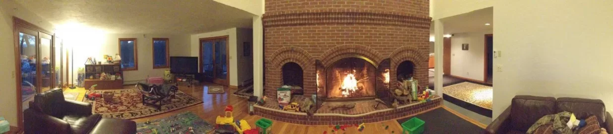

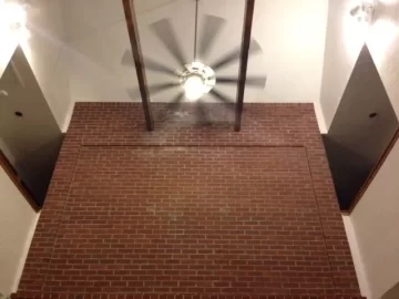

The main room it is in is about 15x18 feet, but more than two levels high (about 25 feet I think). It has a 72 inch large ceiling fan on a long, maybe 6 foot down-rod. Way up high, there are two large 6x5 foot cutouts that expose the upstairs hallways.
Right beside the fireplace room and completely open to it is another 15x18 room with a normal ceiling. On the other side is a 7 foot wide opening to a 9x26 foot room. That room has a wide opening to a 17x20 foot kitchen.

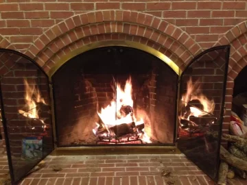

The fireplace opening is 41 inches high in the center, 32 inches high on the ends, and 48 inches wide. I think this one is high enough so that I could use a top-vent stove and push it in a bit.
Along the floor, LEGOs are strewn about.
The flu looks narrow - like 5 inches. Not sure if you can easily take that out? Are there round to rectangular adaptors for lining?

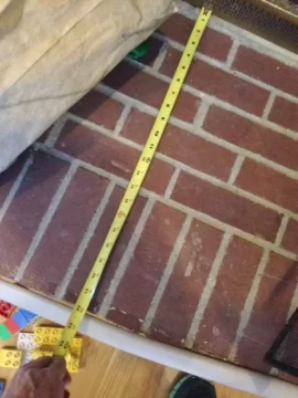

The brick in front of the fireplace extends 22 inches out.
