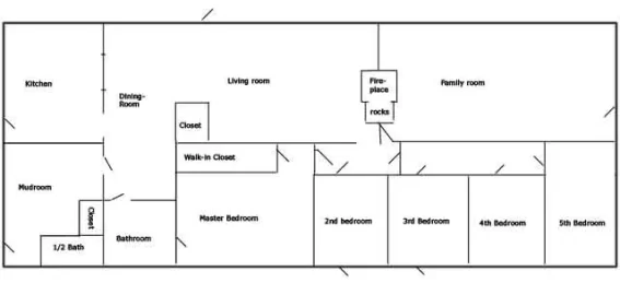

We are in the midst of planning some changes to the heating of our one story, 2890 sqft home. After reading a bit in the forum, I thought I'd post here and get some advice. There seem to be a lot of knowledgeable people around here!
Attached is the floor plan of the house.
Heres the deal: We have an existing, double sided fireplace (with lots of rocks to hold the heat) that is in need of a new chimney and an upgrade with an insert or hearth mounted stove to be used. We would really like to heat our entire home with wood if possible.
There are two duct system sections in the house, split about in the middle of the living room. We have an heat exchanger and a electric furnace in one part, and a heat exchanger with a fan in the other part. I have tried heating with an Outdoor Wood furnace, but I am not happy with this set up for many reasons (e.g. it uses A LOT of wood, hard to maintain for my wife, unreliable etc.). 35% of the basement is unfinished and the rest is crawlspace (not vented to the outside). The house is built in the 60's with a larger addition built in the 70's. We are in the process of changing windows and doors to make it more energy efficient.
There is an opening in the wall from the dining room to the kitchen + a big doorway so it is pretty much open from the kitchen all the way to the fireplace in the living room. Being that the fireplace is double sided, there should be no problems heating the one side of the house. The other side with all the bedrooms is the culprit.
We were thinking about getting e.g a BIS or Opel fireplace insert and ducting it to distribute the heat to those rooms. Does anybody have any experience with how well this works? The other option (and probably cheaper) is to get a hearth mounted stove, e.g an Equinox. The question is if this would be enough to heat the whole house. Maybe we would just have to have electric space heaters in some rooms. Maybe another stove? - not sure where it would be located though.

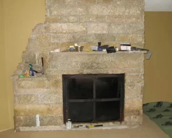

The opening is about 40" high, 45" wide and 40" through.
Attached is a photo of it.
Darn it, yes those fireplaces wouldn't work then of course. What about the Quadra-Fire 5100i? Didn't see anything about any options to duct the heat though.

Hmm, Is the fireplace open clear through on both sides or are there two separate flues and fireplaces on the LR and FR sides? If it's clear through, I'm thinking a freestanding Hearthstone Equinox, exposed on both sides might not only look sharp, but would perform pretty well in there too. You'd need to extend a hearth, but that is quite doable.
If this is one sided, then a big insert like the 5100, Jotul C550, Avalon Olympic or the PE Summit should work. Though all the doors and hallway kind of restrict good circulation for the FR and hall of bedrooms. (Only one full bath for 5 brs?) I might consider a second stove for that area if you find it ends up chilly.

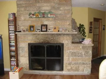

Our fireplace is open right through, attached is a photo of the other side.
I guess the Equinox probably looks like the best solution. If putting in a second stove, where would I put it? With so many rooms and doors, wouldn't it be hard to get any kind of distribution of heat worth anything? I think the far two bedroom will mostly be storage anyway, (at least until we get more kids! :-) ) so it is not a big deal. Do you think the Equinox would distribute enough heat for the master bedroom being that it is not too far away and the kitchen being that it is open right through to the living room? I know it is hard for anybody that hasn't been in our home to answer this but I just thought I'd ask anyway....

With that big ass fireplace open on both sides a monster stove in it with blower, not an insert, is the only way to go. I will yield to the soapstone crowd but a big steel stove like a Pacific Energy Summit or my personal favorite the Englander 30-NC would be the best bet.
You ain't gonna heat a 2,900 sq. ft. one level house with one stove. Ain't gonna happen.

Painful as it is I am going to have to admit I was wrong! I didn't look at that floor plan. Imagine a slapping sound up beside my head.
The way that house is laid out the rooms that won't be well heated ain't where you spend your time anyway. For long lasting heat the Hearthstone Equinox would be a winner. Heck I think the Mansfield might get it done. As would the the big boy steel stoves with the thermal mass of that fireplace.

I'm confused as to why there is a door in the hallway between the 2nd and 3rd bedroom. Removing that little wall and door would help with air movement, if I'm reading that diagram right.

Thanks for your input! The hallway door is actually going to be quite useful this winter, as the rooms down there will be mainly storage and we will keep the door shut. But yes, if we start using them other winters, we might as well take it out. Seems like I have to do an insert to get it approved (hopefully they will even let me do that)....The Summit looks great. How long burn times do you get with softwood? I am in the Parkland area, west of Dauphin. Like your avatar! :-D

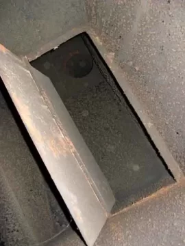

BeGreen - I am sorry for not having been more clear. The fireplace seems to have been a very home-made contraption without much thought in regards to code at all. The firebox is lined with some sort of metal. Then they had a hole in that metal box (behind the damper) where the chimney was going up through the attic, and a massive rock chimney sitting on top of the roof with no support under. The chimney was sinking through the roof and we had to take it down and repair the roof. It was charred around the chimney pipes in the attic, so the whole house could have burnt down. The attached photo is taken laying on my back looking up through the damper. You can also see the outlet for the chimney pipe in the upper corner.
