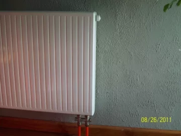

Does any one Know about the Knob at the top of the rad ? I assum it adjusts the flow ? Can I replace the Knob with a TRV or do I have to put the TRV at the inlet on the bottom.
I tried to pull the Knob off for a look But It didn't want to come off easy and I didn't want to break it. There was no manual with these and I got them 3rd party.

Use a product called "radsnaps" to protect exposed pex from sunlight. DO NOT put copper anywhere near those steel panel rads or cast rads if you don't want them to corrode prematurely. I don't like copper anywhere in a system hosting steel/iron rads but that's me. Sure, Joe Schmoe will chime in saying he ran copper 50 years ago in his best friends bosses sons place and no problems since or "I'm the best plumber in Maine and only use copper and people beg me to plumb their homes" BS. Don't do it. PEX-AL is fine just check each fitting & make sure the isolation gasket is there. Its there to protect the brass just as much as it protects the steel/iron. TRV's should thread onto the upper knob after removing the cover which doubles as a manual knob, the top opposite side should have a "coin" bleed valve. Closed systems only for steel rads, no pools/hot tubs and pH balance & test your water yearly. Use auto air vents at all high points. Fix leaks to reduce make-up, its best practice anyhow and those steel units will last forever.

Good catch flame, forgot about the dissimiliar metals & it has been discussed here many times. AFA your other questions re: the rad, best I can suggest is to find the manufacturers label & then spend some www. time at their site AFA the knob which (should) adjust flow & any other Q's you may have. AFA pipe size you will need to know how many btu/hr you want to deliver/use at each rad/zone & pipe according to that required flow to get the btu/hr desired.

Wanted to share my excitement. I just bought actuators off ebay for my rads. Give $17.00 each for them. The Knob I was asking about just screws off and the actuator should screw right
