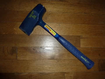

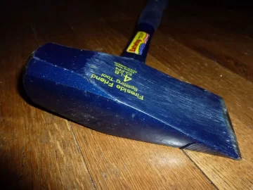

just thinking about quick burning Kindling
Get some dead, straight, easy-splittin' Tulip Poplar or other low-BTU wood, and make some small and medium kindling sticks. One of these hand-held mauls makes quick work of it. But I saw a slight amount of blue paint smears on a few split sticks; Gonna hafta grind the paint off the splitting faces of the maul head...yes, I'm particular about my cats. ==c

I have a good stash of Poplar, And every Little Fiskars Axe/Hatchet/Splitting Axe Made. I'll just have to bust some up into smaller pieces....
The 4# head on the Estwing makes it easy, has enough arse to plow through. But you could just grip further up on an ax to get a similar effect...
