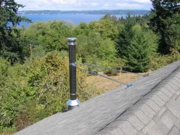

We have about that much chimney pipe above our roof. The chimney needs to be braced at 60" above the roofline.
The stove is meant to be the source of heat, not the stove pipe. Heat loss from single-wall stove pipe is significant. If the flue gases cool down too much then creosote will start condensing once they hit the cooler exterior chimney pipe. You don't want that. Also, double-wall stove pipe has superior construction. The inner liner is stainless which has a much longer life than single-wall.
