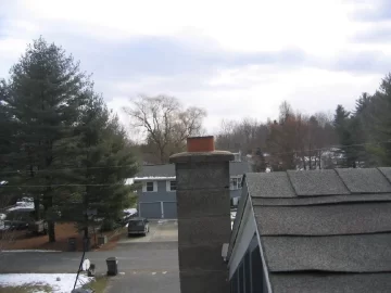

My chimney is maybe a half a foot or so short of the 2' part of 10-3-2. Hard to tell exactly here's a pic:

Wind and a chimney that is just a little short. These two things kinda feed off each other like alcohol and painkillers if you know what i mean. Do you have a chimney cap? A cap might help but it defiantly will do no harm. I am not sure if you can easily extend the chimney you have now or not as I have no experience with masonry chimneys. I always had the prefab metal ones.

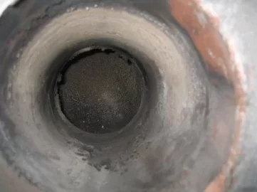

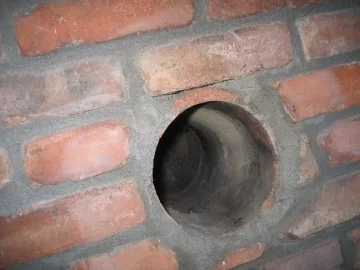

Here are some pics, first the thimble, to see if a hookup is even possible here with stainless 6" this barely takes a single wall 6" pipe:
  • [Hearth.com] Poor draft?

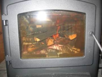

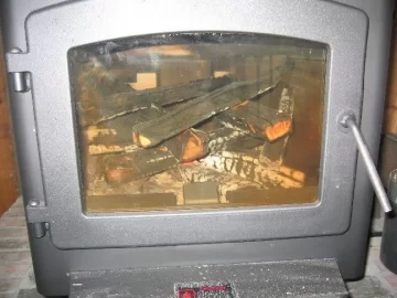

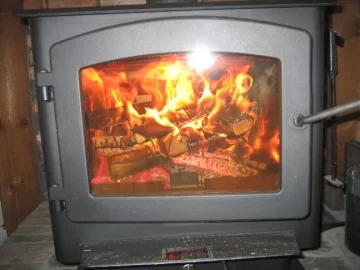

Another thimble pic and pics of the fire
first fire pic with door open about an inch
then i close the door and snap a pic
then 30 secs later
30 secs after that:

last two pics:
