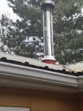

Recently replaced enviro kodiak with osburn 2300.i know its warmer out right now but had somewhat poor draft with the enviro and same with the osburn as temp was around -3 here this morning.i have 9 feet of supervent and 5 feet of doublewall.should i add another 3 feet of supervent and i guess i will need a chimney support as well ?wood is 2 year seasoned pine.

That might work, but first take that cap off and get something that has less restriction to it.
Only 1 other cap that fits supervent and it has a pest screen on it.talked to selkirk yesterday.unless there is an aftermarket universal cap I'm all ears
Before spending money on the class a pipe, you can use a piece of single wall pipe to see if the draft improves. Also make sure the cap is clean then to.
Cap is clean .maybe I will try the other cap.
My wett inspection is with double wall pipe so single wall will void my insurance

The single wall suggestion was just for a temporary test. Grab a length of warm air pipe and put it in there on a calm day. If it improves things then yes, add another 3' of chimney pipe and brace at the 5' point above the roof.
Another test is to open a nearby door or window 1". If that improves things then an outside air supply is advised.
The supervent cap is not real likely to be hurting your situation. They are very open. No screen. No restriction. In my opinion.
Let us know if you test with a temporary piece of single wall. Should be interesting.

It can even be cheap hvac duct. I have less chimney than you at just 8’ class A on top of 48” double wall. It provides plenty of draft.
How do you know you have a problem? Did you measure draft? Everything is the same temperature right now so stoves can be slow to warm up.
I know I have a problem because even with my other stove you cannot open the door to the stove without smoke billowing out at you.even when I open the bypass.i have 2 -45s at the top of my double wall going into chimney.the wood is pine seasoned for 2 years.super dry wood..I have a large tree within 20 feet.could this be an issue?
Yes, a nearby tree can affect draft. Several years back someone posted a notable improvement by cutting down the close-by tree. I would try the warm air duct pipe test with a 3 or 4ft length.

Smoke rollout is what lots of folks call that. Does it happen just when you’re starting a new fire or even when the stove is hot. 14’ is plenty for a noncat to not rollout unless you have something else causing a draft reversal like a dryer, fart fan, range hood, etc.
Still, won’t hurt to extend the flue.
Happens even when stove is hot.no dryer or any other things running.like I said before this has been going on for years and sets my smoke alarms off and freaks the dog out lol.gotta keep my watch dog happy .will try the pipe and let you know

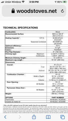

This picture is from your owner manual minimum chimney height.

You also have two 45s which subtract from the effective length.
Did you personally verify that the cap is clean? Those stupid filters can plug up like crazy. You can just take it off to test if it’s the problem. Long term, it keeps the rain out.
Yes had it off yesterday and cleaned it good.

Well neighbor had a 3 foot section of pipe so I put that on and it improved draft a bit but still lots of smoke rollout so just going to live with it as I have for the last 21 years with 3 different stoves.don't think those elbows are helping as well.thanks for all the suggestions and help.stay safe in these crazy times.
