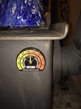

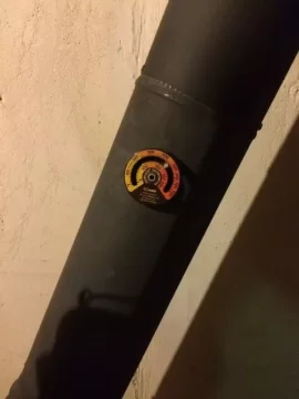

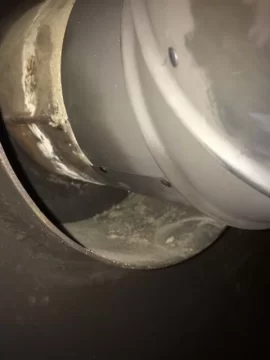

Good evening all,
I just want to take a minute to run this by all the experienced members on this great forum. Tonight I was down in the basement and I was looking at the rear of my mid moe. On the inner bottom part of where the hot water jacket insert is I noticed that I was getting a little red glow on the stove. At first I thought it was my eyes. But sure enough it was not my eyes at all. I was just wondering if this is normal for the design of the stove. I do not over load the stove and I am burning clean seasoned hard wood. Any one else out there come across this same issue? Attached are some pictures of my set up. Thanks again!
[Hearth.com] Possible allnighter issue?[Hearth.com] Possible allnighter issue?[Hearth.com] Possible allnighter issue?
I'd put a baffle in it to reduce the possibility of getting fatigue cracks at that spot.
That stove pipe is hotter than I run - 600* stove top with 300* pipe is my norm with any Fisher. Is there a damper in the pipe? You should be able to save some of that heat before going into the creosote range.

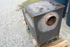

[Hearth.com] Possible allnighter issue? This shows the hottest area on a similar Fisher. No damage was done to this stove.
Extensive use with no baffle can cause these fatigue cracks. Very fixable with a stop drill hole and weld.

Thank you for the reply. I did read the post about adding a baffle and I definitely plan on doing that in the near future. I do have a pipe damper on the single wall pipe. I usually get the stove to around the 400 range but not 600. My stove pipe is always he hotter of the two, will proper operation of the stove pipe damper help increase my stove pipe temp while keeping the pipe at normal mid range temps?
Pipe hotter than the stove doesn't sound right. Do you have a super strong draft causing too much heat to exit the stove? (Partially closing damper will slow the flow if draft is too strong) I found your chimney pics in another thread; Saw where you went from cool condensating to maybe too hot? Placing the stove thermometer on the step top should be much hotter than the pipe above the damper. Hope the baffle is sooner than later. That's what I'd try.
