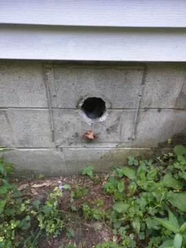

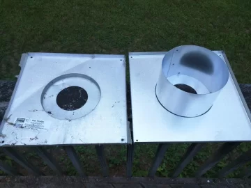

Hey everyone I recently bought a house which the previous owner had a pellet stove so they had the hole in the wall/foundation for the vent pipe to exit. Problem is when I removed what was left of the old thimble the whole is just big enough to put the vent pipe through and not the thimble insert. Should I cut more of the cinderblock out or remove the inside of the thimble like the previous home owner? I just bought a Pelpro PP130 and I'm trying to get it set up.
