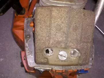

Whats up with this air filter, why would they drill holes in it ??
EDit : found the replacement filter. Is this a different carb ??
[Hearth.com] Poulan® 18 in. 40 cc Wild Thing or Husqvarna 235 16-Inch 34.4cc ???[Hearth.com] Poulan® 18 in. 40 cc Wild Thing or Husqvarna 235 16-Inch 34.4cc ???[Hearth.com] Poulan® 18 in. 40 cc Wild Thing or Husqvarna 235 16-Inch 34.4cc ???
Looks like someone converted an older filter style to fit a newer 61 intake.....then it migrated back to your older style saw.
Not a big deal, I'd just try and seal the 2 extra holes.
Do they/did they make a high top filter & cover for the 61? I seen a few 262/266/268XP's with one over the years....
When I search for a new air filter for the model 61 , what I come up with, does not have a hole in the center it shows two holes, side-by-side, so IDK.
