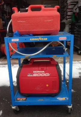

[Hearth.com] Power out - stove cranking away Here is my Utility On A Cart......Power out? ...I roll it onto the driveway, open the vent on the boat gas tank...squeeze the bulb a few times fire up the genny.....plug in my heavy (10 ga) extension cables feeding fridge, pellet stove, freezer, some CFL and LED lights, and yes my oil boiler if I want!!
I have to watch the amps, and usually don't plug in the freezer and fridge at the same time as if both compressors kick in at the same time the gen will trip off on overload....otherwise with a full tank of gas I can run it for up to 5 days.
Obviously I have unplugged all these devices from the house circuits and run everything off extension cords.....not pretty, but no expensive transfer switch.
I like your setup and may copy it.
I have my 2000i on a small movers' dolly that I can roll out the garage door.
I like your extended run time potential and that you can probably put the electric cord on the middle shelf.

I've been thinking of that setup; almost have my husband convinced. We very rarely lose power, but as we're getting on in years, we should be better prepared. I bought a portable kerosene heater about 5 years ago; it's never come out of the box. The Honda 2000i would be good to just be able to keep the pellet stove going and a few lights. A couple weeks ago during one of those 5 degree nights we lost power for only an hour. Boy did that temperature drop fast! This thread gave me the push I need to take the plunge.
That Honda 2000i can easily power my oil boiler. Not sure about the power requirements of a furnace.
Most forced air furnaces run on a 115V 15/20 amp circuit (depending on the blower motor). I believe the 2000i can handle those loads.
ETA - That is a 2000 MAX load with 1600W running load. So it probably can, but you will be maxing the little dude out on blower startup.
