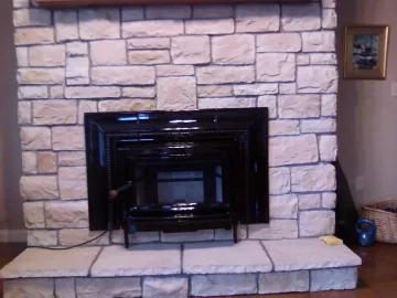

For a tear out and Kozy replacement expect at least a $6K bill, maybe higher depending on whether the chimney pipe has to be replaced or not. A couple of the most cost effective options would be install an insert with liner or extend the hearth and drop a liner, then connect it to a freestanding, rear-vent stove.
If you use the Kozy Z-42 the chimney would need replaced with a class a system. It can be done, but would require removal of some drywall to expand the opening, and a new chase cover and possibly removal of some siding. We have done a few this way. But your cheapest option is going to be putting in an insert or a stove set-up like BG mentioned. There a few really nice units that are approved for pre-fabs. We did a Jotul today and this Hearthstone Clydesdale last week. Both were in pre-fabs.

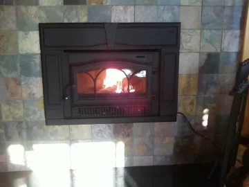

Here is the Jotul that we did today. The chase was bumped out from the house and wasn't part of the basement. What you have is very common, when they do this the builder runs an additional set of floor joists out to support the chase. If you did the alcove thing, then you wouldn't have to remove the chimney chase as the guy said. You would need to remove the old fireplace and all the components, raise the ceiling height and replace the flue with class A chimney. You might not have enough width to actually recess a stove into the alcove though.
