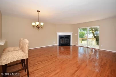

Hey everyone. I just bought a new home and it has a prefab fireplace installed with a fan which I plan to use this winter just to see how it heats, if at all, but also because I will most likely be busy with new home ownership and won't have the time/funds to dive right into a fireplace insert. I was hoping to get some of your guys thoughts and opinions on an insert that I could possibly work with. I took some pictures (dunno if they will be helpful and can take more once fully moved in), but my unofficial measurements seem to be 15 3/4 (maybe 16) deep and 29 or so across and 40 x 40in on the outside from door to door and floor to the top of the unit. I attempted to get a model number but did not see any on the inside of the doors or firebox. This is a town home with a chase so I'm guessing I will need a grade A liner or something of the sort to line the chimney. Any thoughts you guys could give me I would greatly appreciate. Thanks. Let me know if the pictures help at all.

We will need the make and model of the fireplace in order to tell you if an insert is allowed. I am also curious what that u channel is about i have never seen that before.
I was severely limited by size and approval for my EC-36 prefab. As bholler says, make and model are needed to do that research. Just FYI, I ended up with a Hampton HI200. It is a nice little heater and works as advertised but there is only so much you can do with a 1.4 ft3 firebox. My other options were the Quad 2700i (1.8 ft3) and the Lopi Revere (2.2 ft3) which was my choice but my wife demanded the HI200 for looks.

Thanks for the ideas. I guess the first order of business is to find the make and model of this thing and then have a dealer/installer to come out and give me a bunch of details and then reconvene on here for some opinions and insight. Thanks for the help. The house is 1200 sq. ft with a 600 sq. ft basement (fireplace is on the main floor). I am looking to stay with an insert if possible as it won't stick out as far as a free standing stove, however if the insert is in no way a possibility once I get more details I am definitely open to a free standing stove or maybe even a pellet stove.

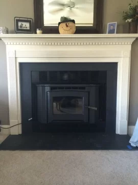

I just installed an Enviro Venice 1200 into a pre-fab zero clearance similar to yours. Mine also had the louvers underneath the pre-fab fire-brick floor. I removed the lower louver and discovered the fire-brick floor was only supported by sheet metal screws! The area under the firebrick floor was exactly 6". So I laid out where the feet of the insert would go and put 6"x6"x 1/4" tube steel tight to the floor bottom to carry the load of the new insert and full height insulated liner. Had I not looked under that floor and added that steel it would have collapsed. I had a sweep come over and do the final install, I showed him what I had done and he said "a little over kill but if it helps you sleep at night more power to ya!" So my point to this whole thing is please look at the structural integrity of the existing pre-fab before you but in a 300lb insert with an additional 100lbs of chimney liner on top of it.
Here is a picture the day it was installed, actually it was Aug 26th. And yes I'm in the process of changing the mantle clearances...

That is sweet looking. That is all I want, simple but efficient and effective. Did you do all the chimney liner work yourself or have the installer do it? Also if you don't mind me asking what it ran you for everything? I am not very handy in the woodstove/fireplace/chimney area. I know how to spot, split, and stack good wood and tell when its seasoned and can operate a wood stove well but the know how to install anything I am clueless.

I will say that it is very likely that your prefab fireplace says that you are not allowed to install an insert in it. Most don't allow it. The way i see it that means it cant be done and still be code compliant. You will have to make that decision yourself after explaining the situation to your insurance company and getting their ok

A freestanding stove on the hearth in front of the prefab is ok as long as a full liner is run up to the cap. The would require extending the hearth and a rear-venting stove with a flue collar height that is below the top of the door opening. Or tear out the whole shebang and put a proper hearth + freestanding stove in that corner. Or replace it with an EPA fireplace. Or just try it out for a year as previously suggested.

srussell, I did a full lining from stove top to chimney cap. It is a pre-insulated 6" liner .006 stainless steel inside 1/2" of ceramic insulation and .005 outer stainless steel wrap approx. 31' long. It was not to difficult to install into the existing 8" pre-fab chimney. Like the others said, check with your insurance company also your building inspector and or local fire marshal. I interviewed (3) different chimney sweeps to help me with this and the one that was the most detail oriented and had installed inserts into pre-fab units before is the one I selected. He signed off the unit and I submitted all the paper work to the insurance company and to the manufacturer of the insert and they accepted it for the registration and warranty. keep in mind you must keep all existing louvers and air vents open around the existing fireplace and you cannot modify it in any way with the exception of removing the flu damper and the spark screen and track. I did not order the surround for that reason, it would have covered the vents. I am making custom trim pieces that are only 4" wide for the sides and an 1 1/2" wide for the top.
