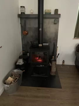

not sure what types of pics you need, but this is one I have already taken. Note, there is no damper, I just had that metal sign and stuck it on the stove for character. The OAK runs out the wall to the left. We are on a crawlspace. The temps the day I had the most trouble was approx. 39 degrees that morning outside. I do use a propane torch to light the stove so I could try using it to preheat. Thank you.

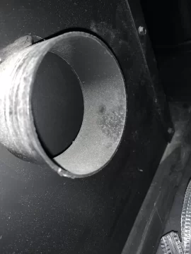

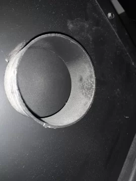

Well it looks like there is no plate blocking my OAK on the back of the stove. Or I don’t think so. I took the flexible pipe off and looked inside. The hole goes in about 2” and there is metal there but it seems more like a channel. I can stick my finger up and in the area around the inside of the inlet. So doesn’t seem like a cut off plate if that makes sense. Is that installed correctly or so o need to do something to fix an issue? Thank you.
  • [Hearth.com] Preheat flu

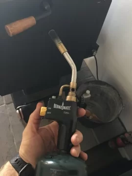

Forget the hair dryer, preheat with one of these and then use it to start the fire.
Everything seems to work better as the outside temperature cools but basement installs often have problems.
