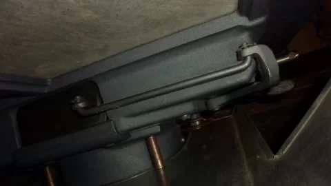

After bholler said "As soon as you open that door there is no air being pulled through the intake," I got to wondering if I could see how much difference it makes on my stove, air shut vs. open. This pic is shot vertically from the bottom/back of the stove, and shows how visible the air intake is. It should be easy with a stick of incense, testing both the door opening and the intake, to tell how much difference there is, air open vs. shut. But right now, my rear heat shield is blocking easy access, so I'd have to remove it before I can check.

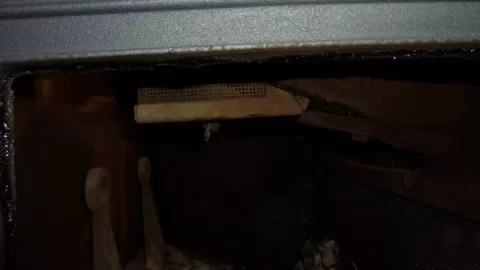

The bypass opening to the flue looks to be lower than the top of the door opening. Seems like the door should be lower.
Might be hard to see, but the flue exit is at the right/top of this pic, to the right of the light-colored piece, slanting down toward the back of the stove. You can see a hex bolt head in the cast bypass frame/flue exit The front (highest point of the opening) is still about 1" below the top of the door opening. The rear of the slanted flue exit may be 2" below the top of the door opening.
I don't get smoke roll-out on 16' of stack, even though the stove is rear-vented. There are some areas in the top of the fire box that are higher than the door opening, like the air wash and the side area between the flue exit and the door...maybe that helps? The draft is also focused on a smaller opening with my side-loader...on a front-loader you have a much larger opening. Less draft per sq.in. of opening.
