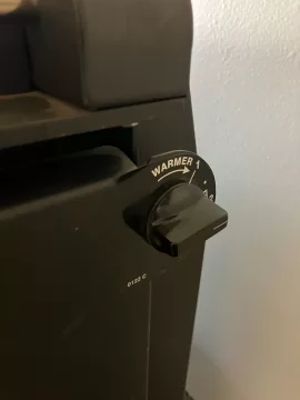

I don't know how common this is, but I've never installed the side panels on my free-standing Princess. I don't have fans and don't feel that I need them - the stove keeps our 600 sq-ft " great room" (living/dining/kitchen) quite cozy without them - and I think the mostly radiant heat emission works better without the side panels. I am open to different opinions on this though.
What this means is that the control knob has no scale to adjust it against. It just hangs out there several inches from the side of the stove.
[Hearth.com] Princess temperature control w/o side panels
This is not ideal for setting the level for overnight burns, so as to avoid stalling the cat while also avoiding burning up most of the wood load. I've been winging it for awhile now, but I'd prefer better control. Has anyone addressed this issue ? I suppose one option would be to cut off a few inches of the rod that holds the knob, so that it's very near the rear edge, and then fabricate some sort of gauge and screw that to the back of the stove using the screw hole that holds the little panel on the back where I guess the fans mount. Any other ideas ?

Get a bar magnet and then a small piece of sheet metal painted black- high heat. Make a bend to attach it to the magnet. Then cut a slot slightly bigger than the shaft and slide it on. Then attach a metal pointer to the shaft with Black RTV.

I would try and clamp something to that rod with a pointer near the stove body. Heck, a little piece of that metal plumbing tape and a little bolt and nut. All you need is a pointer that is fixed to the rod. Then you can choose to use the stove body for reference or if you want to add a flag type dial to the stove body right next to that pointer.
My princess has the side shields. It came with them installed. They're only like a half inch farther out than the stove body and the knob is right there. Why the heck is your rod so long? It's much shorter on my princess. The knob almost touches the side panel.
Perhaps your thermostat has been replaced and not cut to length as described by @tabner ?

Indeed, it was replaced, because fof the "reverse wound" fault.
I think I'm going to install my side shields, see how I like that. But yeah, the knob will still be way too far from the dial. Need to cut the shaft; just with a hacksaw I guess, but I worry a little about all the vibration from that, since evidently the connection of the rod to the thermostat-proper has some sublety to it.
i believe i used a hack saw, put the rod in a vice to hold it nice and steady, minimizing vibration. It's not a super strong metal, cut it half way through and then bend it and it snapped right off - if i remember correctly.
Okay, crazy option, since your username involves rusty shackles you probably know how to cut the old dial off of the sideshields and leave enough extra metal to fold over and attach to the stove back wall so that the factory dial is installed on your stove but just without the sideshield. That might support the rod from flopping around too. I would cut that stat rod to the correct length in any case.
I think you should put the sideshields on and try it as intended by BK. The sideshields have nothing to do with the fans, the fans blow up the back and over top of the stove, not the sides. With the sideshields it looks better (less big mac box shape), is safer, and you can cut the rod to length to use the dial as intended. We stay plenty warm with those sideshields and almost never use the fans.
I have found that grinding things off causes less stress than hacksawing. You can use vice grips to stabilize it. If you need to make a pointer on the shaft, I was thinking a long thin piece of aluminum with the end made round, and then RTV'd on.
