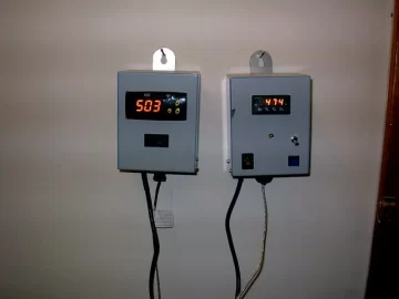

The monitor/alarms I have, I built myself with off the shelf components.
( This was before Auberins came out with there version.)
Mine actually does more than just monitor/alarm.
The flue controller automatically closed the air when the temp reaches 875::F
and the stove top turns on the blower when the stove top reaches 700::F
