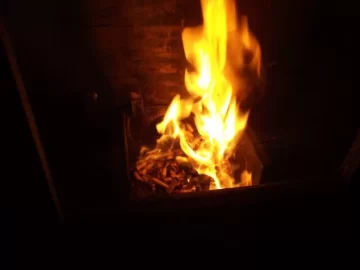

we have a small prob with our Englander 25-PDVC
on feeder rate he use ca 50lb of pellets/day.. that's a lot to match and he overheat the Area where he is sitting.
is there a way to reprogram the feeder settings to a lower amount ??
this video and the pic is made at the end of the startup
(broken link removed to http://www.schwanewede.ca/stove.mp4)
this picture is made on setting 1 - 3 !!! the fire will be some bigger 10 min later

What is the 3 bottom buttons set at? Factory is 641
thx
jep that's what the stove give back
but it's to match
is there a way to lower the feeder rate ???
Start the stove with bottom bottoms on 641 heat setting on 5 fan on 5 when fire is burning and convection fan turns on move heat on 1 fan on 1 set bottom buttons at 461 that will slow feed rate.
the stove is on 641 and it runs on 1 1
but it's to hot :(
Do what I said in my last post move bottom 3 numbers to 461 in other words change the low fuel feed button to 4 and run it on 1 1...if you need more heat change back to 641 and move your heat and fan button to desired comfort level.

Did you ever change your mode c or d?
I was given those directions by ESW last year because I was being cooked out in warmer weather, it works
no never i don't know how to change the 641 settings
You can also try 3 on low fuel feed but don't go lower than that try 4 for a while and try it
Press the lower left button ( low fuel feed) the # 6 should come up press arrows to adjust same for low burn air
If you didn't change your mode then don't worry about it, it should be factory...we can deal with that later if what I said don't work.
thx have my girl on the phone and she try it
at the moment 341
will monitor the fire now and mybe set back to 441
thx
fred
I still would change the middle # to 6 (low burn air). Keep it on 1 1. Yep play with 3 or 4 on your low fuel feed I'm sure you will get close to the results you are looking for.
Just remember if you change the heat range above 1 move your low fuel feed back to 6
I must be having a brain fart, low burn air should be 4 not 6 you were correct...run 441 or 341 sorry about that.
Denny
Hi,
we running now on 541 and we are fine with it.
thx for you help.
fred
