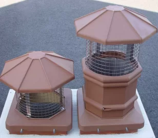

We also have nicer looking ones, like the enclosed. Separation of the exhaust heights usually solves this problem.
  • [Hearth.com] Problem with smoke
