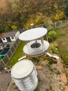

You have what appears to be a perfectly adequate piece of sheet metal at the top of the chimney bridging the gap between bricks and round metal pipe.
Which leads me to believe all the wind I can hear is coming down the flue and therefore into the stove, so that needs to be resolved firstly I guess

plenty of stack height. 8-9 meters, no elbows, is 26.24 to 29.5 feet. You should have excessive draft
But when the wind blows, you can see it affecting your fire in the stove at the bottom of the pipe in a bad way, and when you open the loading door you get smoked out regularly.
And when you lit a fire in the bare fireplace you did not have good draft, though you had more better draft when you opened a window.
You said you have no through the wall appliances like a clothes dryer or venting fan over the cook stove in the kitchen running. Other than the chimney for your word burner, is there anything else in the house that pumps air from inside the house to the outdoors? Anything at all? I have two courtesy fans in my house, one in each bathroom, but they don't move enough air to affect my wood burner, even with both of them running.
What about your common wall neighbor? It has to be asked. If your neighbor is a professional chef with an enormous range hood moving a lot of air he _might_ be applying suction to any airleaks in the common wall. Maybe. Are they any holes in the wall, check the basement/ cellar too? Can you feel air moving through the hole? Are you allowed by code or common sense to block the hole, if you find one?
1. Do not add a bunch of stack height trying to get out of your local downdraft. If you take your chimney up to 45 feet/ 15 meters and it starts drawing good you will melt expensive things.
2. What fuel is burned in the other side of the semidetached with the different cowl on it? Is that a standard cowl for say natural gas or something?
3. Trees 25 meters away and only 5 meters taller than your stack are most likely not the problem. They might be. What about dirt piles like ridges or scarps or hills? Which direction, how far, how tall are they? Where does the prevailing wind blow from in your area and has it been deflected by the hill/ridge on your lot?
4. How many houses/ blocks/ miles would you have to walk from your house to find another wood burner? Are they operating with a funky cowl on top of their chimney? Have they been burning long enough to know what they are doing?
