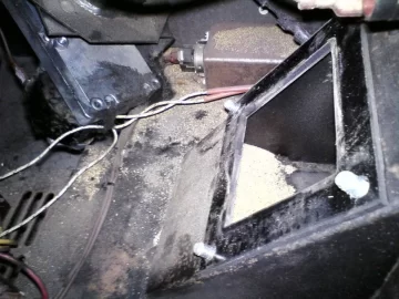

1/4'' of play certainly indicates a worn out nylatron bushing. Another indication is all the sawdust leaking through the clearance inside of stove.
Some of the leaking sawdust will get sucked up by the convection blower and out in the room through the glowing heat exchanger tubes. Some members here on the forum have noticed sparks coming out from the heat exchanger, so this could be a potential fire hazard.
I suggest you replace the worn nylatron bushing as soon as possible.
When I bought my Whitfield stove in 2008 the nylatron bushing was also badly worn and a lot of sawdust was leaking inside the stove. I took a picture of it. The convection blower is removed and you can see sawdust everywhere. Note, how some sawdust has settled in the cavity under the blower mounting. Some of it must have entered the room through the heat exchanger tubes, but I never noticed any sparks. Very low humidity of pellets and room air may be contributing factors that could ignite the sawdust. And of course running the stove at the highest heat setting with a badly clogged room blower!!
