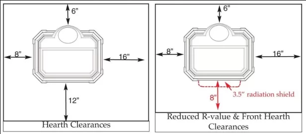

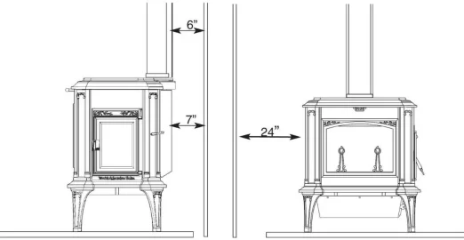

Note that Woodstock posted the corner clearance spec yesterday. It's 12" Here's the complete set. It appears that the rear clearances are for double-wall pipe or shielded single-wall. I've asked Woodstock if they have the single-wall pipe clearances yet.

i asked woodstock and they didnt seem to know what i was talking about, so maybe it isnt an issue. they asked me for my measurements but since im in iraq i couldnt provide that info. thanks for posting those diagrams, the internet service i am currently using has the woodstock blog blocked for some reason. i cant wait to get home and rip my old hearth out and build it the way i want.

That 24" on the side is killing me :( I have that right now (exactly) for my FV, but with the wider stove if I keep my pipe vertical I lose a couple inches... ug. Add another glitch to my plans... So shielding on the wall? Slant the pipe a bit and shift the stove to the left? The blog post seems to imply they might reduce this after a bit more testing.... I wonder how much more...
Hate to move my whole chimney (hole and all) a few inches to the side...
Slow1:
That' a bummer. I just got off the phone w/ WS and asked about side clearance. Its measured perpendicular from the side of the stove, not in a radius, if that helps. Sounds like you don't have a fireplace installation like mine. i forgot to ask them when the stoves were going to start shipping. How is your Hearth - is it up to spec?
