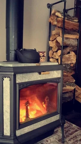

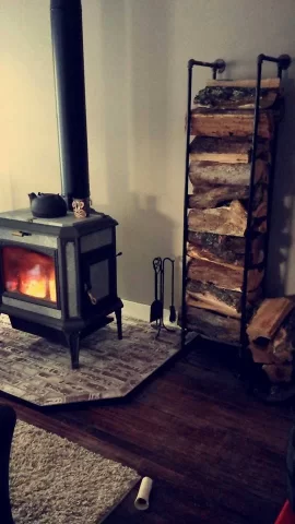

I built a new firewood rack next to my PH out of black pipe to dry wood a little before I burn it. I guess my problem is burning less than ideally seasoned wood. I have some really dry softwoods I burn hot to clear the glass. I'm going to get on drying wood for next year and preferably the next couple years after that so I don't have to deal with this again. Here's some photos.
Sweet setup..... As your wood seasons more not only will your glass stay cleaner but the overall performance of your PH will improve. Stove top temps and burn times stand to benefit.
