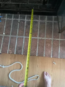

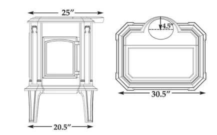

I recently purchased a Woodstock Soapstone Progress Hybrid (short legs)to install in my masonry fireplace with clearances that appear to be much like what you have. I was hoping someone could advise how far back into the fireplace I can place the stove and still maintain functionality. The stove is 25" in total depth so is recessing it into the fireplace 6" - 8" feasible and still be able to load, adjust the damper and open the top to clean the cat? My initial measurements provided more room to place it on the hearth and I'm hoping I have some room for error.
My fireplace dimensions are 29" (h) x 42" (w) x 28" (d). My hearth extends 19" - 20" past the lintel and is 10" off the floor. I understand it may be tight but can it work?
Any insight would be a great help. Thanks.

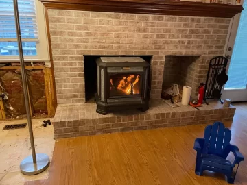

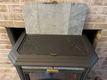

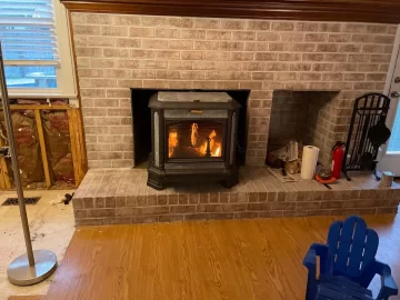

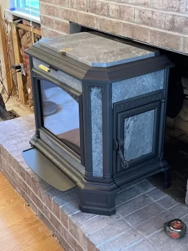

so I just ended up recessing the stove. I whitewashed the brick with acrylic that is holding up well. I can access the catalyst and damper well. Overall, I had about 7"-8" to recess the stove and keep functionality. Here are some pics for reference. It's tight but it can be done. I still have about 1"-2" to the edge of the hearth. I appreciate everyone's feedback.
