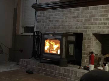

Hey All! Just recently joined this forum and this is my first post. Heard about the Progress Hybrid here (and so much other wonderful advice!), which led to me purchasing one. As shown below, we recently had it installed last week, replacing an old VC 1977 Vigilant that came with the house. We are so pleased with the stove and can't wait to get some more use of it next winter.

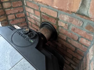

I did have one concern with the way it was installed. The installers had to remove an old 8" thimble and drill out some bricks to get the liner to pass through. They came back to finish the job (work is shown in pics below) and it seems that they didn't install an actual thimble ring as we had before with the VC stove--they merely cemented around the liner directly and threw on a cheap metal ring. Is this appropriate? Can the chimney cement be in direct contact with the liner connection like this? I'm worried that the expansion of the pipe (when heated) will cause the cement to crumble.

A 3/8" stove rope gasket would provide a more flexible seal to address the concerns. If the cement does crumble out, then replace it with this.
How do you clean the flue with this setup?

Gotcha. Thanks for your reply @begreen! I haven't cleaned the flue yet, as we only just installed the stove a few weeks ago. But I'm thinking of placing some furniture slider pads under the feet, sliding the stove forward, then cleaning bottom up with a sooteater. Any ideas for making this easier??

Personally, I think I wouldn't have bricked up the area behind the stove and instead left it open or with a removable cover. That would permit a tee with a clean-out cap. This is a heavy stove so frequent moves seem like a pain.
If it were me, that is exactly what I would do, even if it meant extending the Hearth.

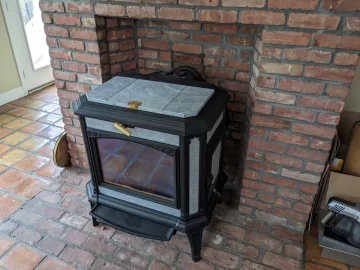

I do have a quick question regarding the stove size, how far back in the fireplace can you place the stove and still maintain functionality (load wood, adjust the damper, and open the top to the clean cat)? Assume the height of the fireplace is 29" and the width is 40".

It looks to me like if you insert it any further than 8.5" into the fireplace (measured from flue outlet), you will have problems getting the lid to open.

That’s what I’m hoping for. I won’t go that far back but it’s nice to have the flexibility. I appreciate the feedback. Thanks .

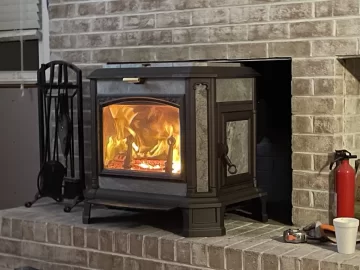

So far I really like it (installed 3 days ago). It likes to run around 400 degrees (stove top) and warms my ranch well. I need to get a fan ti warm the bedrooms, though.
The hottest I’ve taken the stove is 500 but may change as the weather gets colder.
It’s a handsome stove and is a nice focal point fo the room.
