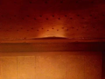

i was cleaning my progress hybrid stove when I noticed what looks like the fireback(I guess that's what they call the secondary plate in there) is warped right in the middle. Any one else notice this? Is this common? It makes me wonder how it got like that. The stove normally only runs around 350-450 range and I've only seen it hit 600 one time when I loaded it down with a bunch of smalls. Any ideas? I guess I should call Woodstock and inquire. They've been 100% great on any other issues I've encounteted.

Notice any difference in operation?
Do you ever open the air more than 1/4 open other than when starting a fire or burning down coals? I saw that blurb in the manual, not sure if that could be the cause or not.
No....once the stove top is up around 350 we shut it down to around 1/8 to 1/4 open. That's all we ever really need
Seems to operate ok but I can see that it appears the rope gasket is missing in that spot...I would think I would be losing some efficiency somewhere but I could be wrong.
You can see in the pic where the stainless has a different color around that area where it's leaking
Could be that an air leak in that area is overheating it. How old is the stove?

You should send that photo to Woodstock and see what they say.
I'd contact Woodstock, I burn mine at 550 most of the last few weeks and its still straight as an arrow.
Some early stoves got a rebuild due to similar issues - ours is a Jan 2012 model and got the rebuild by Woodstock in the summer of 2013.
Yes, get in touch with Woodstock. They'll take care of this. That plate connection is significantly beefed up in the present edition.
Doesn't cost anything.
I think they may take your stove back and ship you a rebuilt one, or perhaps rebuild yours at the factory over the summer.
Don't worry, and call them next week.
Ok...in the mean time I filled the gap with some gasket material and a little cement! I hated to but I still need to use it and i don't want to take any chances on it! Kind of frustrating but with the luck I've had out of Woodstock so far in sure it won't be an issue. I never really paid that much attention until the other I noticed what looked like 4-5"of gasket missing right there.

Some of the early PHs had the OP's issue. Look at the photo and then compare it to your stove - where the photo has a gasket'ed joint held by screws (or rivets?), my rebuilt version has 7 welds across that span plus the screws (can't see in there well enough right now to know if those really are screws or not), with no gasket material showing. Ours began to show issues after 5-8 cord went through it. We finished out the 2012-2013 burn season with it like that, and they fixed it in the summer of 2013. Access to that part is not trivial - the cast top of the stove comes off and quite a few parts come out.
