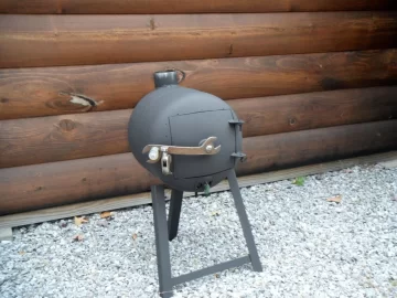

I have not posted on here in quite some time. I posted this on a different forum and it was suggested that you folks may enjoy seeing this. I actually posted one of these years back that I had made for use on my patio. This little guy is for my shed/workshop. I ran it today and it did pretty good and is very controllable. Anyway here is a picture. Made with mostly found objects and some 3" exhaust pipe and adapters for a flue. [Hearth.com] Propane tank wood stove
Looks cool, fun small stove. This is a photo shop, not sure why. The vent on the bottom front is way low. Ashes, coals could fall out and when it gets a build up layer of ash it would stop letting air in.

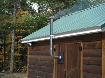

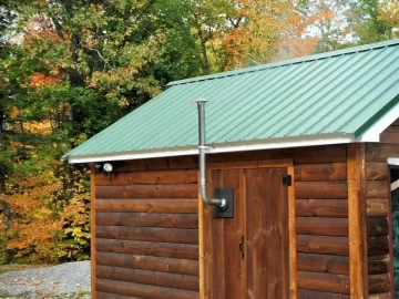

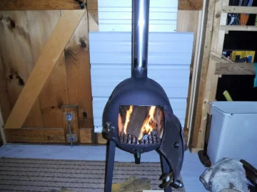

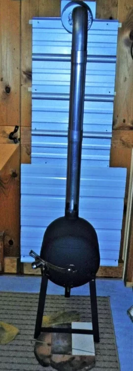

It is very stable with the three legs, no rocking like it would with four. I have a grate that sits even with the bottom lip of the door opening so it would take a lot of ash to block air flow. I have some screen behind the air vent so nothing can fall out. I have a few pics of it running just for testing so no floor protector down at the moment so I don't need a lecture on safety lol. ;) This is a portable setup so it is meant to be easily broken down in warm weather to get it out of the way. That's why it is installed the way it is and where it is.[Hearth.com] Propane tank wood stove [Hearth.com] Propane tank wood stove [Hearth.com] Propane tank wood stove [Hearth.com] Propane tank wood stove
Stove is cute, chimney is not. It should be class A passing through the wall and outdoors. Also doesn't look tall enough to meet the 10-3-2 rule.
I tend to agree with your assessment but this is only going to be used when I am in the building. It draws like a champ and my roof is steel it also has a very small firebox so I won't lose any sleep over it. I have run it hard now and I have found nothing scary going on. I do appreciate your opinion.
Not opinion, code. Wood pyrolysis doesn't happen all at once, but over time. This would be much safer with a proper chimney.

I don't know of any 3inch woodstove pipe. I did search and I could find nothing. So let me pick your brain and ask what would you use in this case. This being a one off item with a 3 inch outlet.
You're probably correct, 3" is tiny. 5" pipe is the smallest that Duravent or MetalBest makes. That should still work ok with an increaser at the thimble.

10 3 2 and a steel roof.
I did my pipe w the 10 3 2 rule and a steel roof but both the fire chief and building inspector made comment on the metal roof and said it was a non combustible and I exceeded what I had to.
There was NO permit required for the install, but knowing both of these guys personally, I still had em take a look at the install and asked for their off the record blessing (since there is no official record offered).
So does it matter if it's a steel roof or not when calculating chimney height?
I know from what I learned the height also has to do with drafting. If the pipe is not above the peak it can cause problems with the draw of the flue. I'm not having any issues there. And a steel roof being non combustible makes me feel it will be plenty safe be there a spark or two. I have a thimble and I know, it's a Pellet pipe thimble but my flue is 3 inch so it is working fine for me and does not get hot at all. Don't ya love living in a free state neighbor?
Wood stove chimney pipe is rated at 2100::F Pellet stove pipe is rated at 570::F A wood chimney thimble when passing through a wall needs much more protection due to higher temperatures. It has no insulation protection and keeps wood at closer clearances due to the lower temp operation it is designed for. This is nothing like a class A thimble with thickly insulated pipe. The stove is cute, but the chimney installation is simply unsafe. So is the meager hearth.
