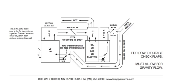

I like this set up from the Kuuma manual. A heat dump is a good idea. [Hearth.com] PSG Max Caddy

I like this set up from the Kuuma manual. A heat dump is a good idea.View attachment 130074
I don't like that, I think the flap should be on the fossil fuel unit. What if power goes out and nobody is home or are sleeping. I think the best would be a motorized dampers, 1 normally open and 1 normally closed. When the fossil fuel unit runs it powers them in the opposite direction.

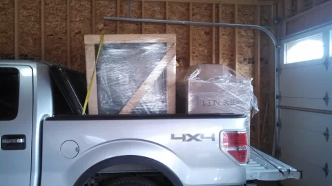

Caddy arrived today wo[Hearth.com] PSG Max Caddy nt be able to get into the basement till Sunday or Monday have never seen one in person I am quite impressed

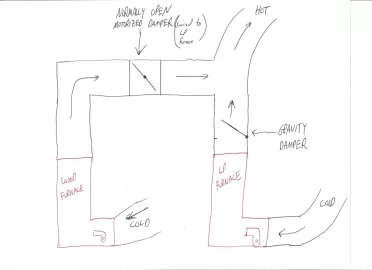

Attached is a crude sketch of how I'm going to be having mine setup. Any comments/concerns?? newyorker, is this how your going to do things as well?
The cold air for the LP furnace is connected to the cold air ducts, while the cold air for the wood furnace will be a combination of an open staircase and laundry chute, which extends from the basement up to the second floor loft and has an open grate on it. The chute also has an opening in the first floor bathroom which I may remove the door for winter to allow even more possible places to pull from. The HVAC guy said I will have very good circulation with things setup like that.

That's exactly how in doing mine I think except I'm hooking in a return
What I mean is ! only. For instance, wood furnace beside oil furnace. Supply of the wood furnace feeds the duct 1st, then the oil with the gravity damper. So when the oil fan runs it pushes the damper open, by doing this it seals off the wood furnace supply. 1 damper 2 duties.
That's basically how our works. If it would happen to close the dampers above the woodfurnace, I can manually open them. The only way our damper would be closed above the woodfurnace is if the lp furnace ran and the woodfurnace didn't.
