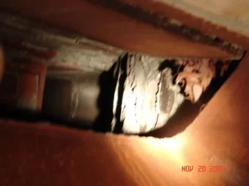

Ice - can you take some pictures? I'm not sure if others do - but I'm not understanding what the real problem issue is (of course - I'm not saying that there's not a problem... just can't picture what you have).
ok looked up as far as i could see with mirror will have to go from the top down
question : not clear about this wouldn't a block off plate prevent heat from getting up the flue into a header
also my chimney is kinda like a wall on the interior i have a total of 6 flues the chimney at it widest point is 14 ft wide in the basement which has steel beams on either side of it
on the next floor is about 12ft wide going up into the crawl space(insulation area) i didn't measure but when it comes out on the roof its at least 6 ft wide if not bigger i will try to post pic of my house but don't know how
this chimney has never been used was inspected a couple of years ago and was "in brand new condition"
i just don't wanna burn the house down
and i learned something new so i am looking for any problems
i just wasn't sure where i was to look
i think i am fine seeing i am going to line the a never been used before chinmey but ... like elk says better safe than sorry
plus one thing i am finding out on this site is when people do come over they just do things and leave ..its almost as if they don't know as much as the people here or just wanna get in and out...
much thanks to all you guys
so far i have had some tell me i didn't need to put a block plate at the end of my liner because i had a cap i could basically just let the liner rest up against the flue or jimmy with a bolt
i have been told a block off plate at the insert end was not needed and if i was that worried just put the plate on top of the chimney

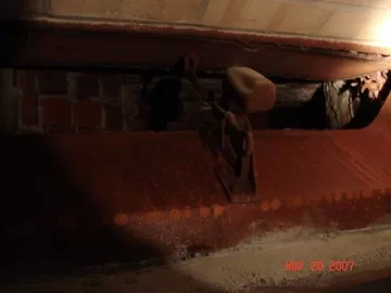

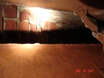

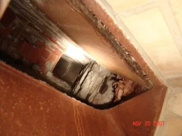

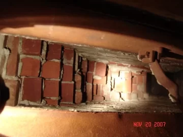

For now... maybe this will help.... let's focus on the flue that the insert will be going into (you have 6?). Tell us what's around it. The measurements in feet do seem a little unusual (to me anyway). What is the size of the flue, and what condition is it in. Again... pictures would helo a great deal
if you have some.... just look at the bottom of the bottom of your response post, where you will see "attachments"... you should be able to send them there.

here are some more

one more it was tough holding flashlight and sony cam

OK, as the Buddha says, everything in moderation. If we read this thread, it probably means that 90% of the inserts being sold and installed cannot be done, so that means all the manufacturers will be out of business in about 6 months!
So please let's focus on the original post. It was this - AN OPEN FIREPLACE - AN OPEN MASONRY FIREPLACE.
The truisms are this - that NO masonry fireplace is tested to any sort of UL standards, and therefore they (all in all) provide a completely untested and listed way of burning a fire. Truth is, they were designed and built for show, not for looks. My guess would be that the masonry fireplace in question was used pretty hard in order to ignite that header.
Since even a perfectly constructed and inspected masonry fireplace cannot handle the full time heat of an open fire in it, it is no surprise that these situations happen once in a while. Try running your generator, car engine or boat 24 hours a day and you will find out really quickly that they are designed for a certain job.
OK, so onto the insert - in almost every case, a fireplace is made VASTLY safer with a fireplace insert and a chimney liner properly installed into it - in fact, so much so that I personally have not heard of a fire caused by similar circumstances with these installation (ignition of headers)....not saying it has not happened, just that the degree of safety has been increased.
A person who wants 100% safety should simply not burn wood and install the newest and highest quality central heating system available. Whether by an ember falling out the front or other means, a fire in the living areas is by definition more dangerous than none.
Bottom line - you need to know all this information as basics, but too much detail would be like me demonstrating the amount of dangerous germs which you are touching every time you enter a public space - they can KILL you...and even painfully.
So become educated, but do not become paranoid.
