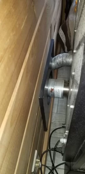

  • [Hearth.com] Pulled the trigger on the Ravelli RV80

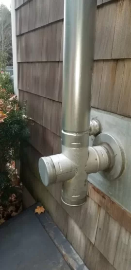

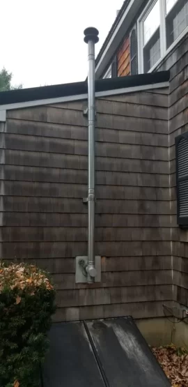

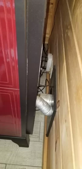

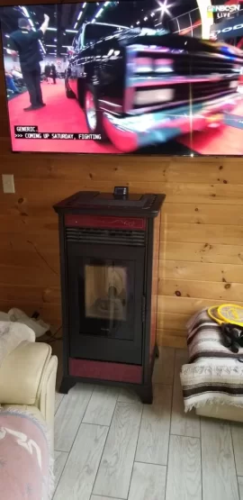

Very nice ceramic flooring I hope

RV80 I chipped the top of the lower tile! Ugh!
I like to share my experience install a Ravelli RV80 pellet stove. It’s also 2” off center.
Start with the off-center issue. The new pipe doesn’t allow you to twist the angle of the 45 and 90s. So to get things together I end up off-center by 2”. The old one did allow this minor change. Oh well a 20” stove in front of 53” stone face. You can’t see it.
