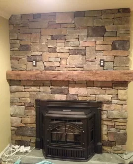

Anyway, we ended up building a fireplace for our new home and I figured i'd share.
[Hearth.com] Purchased a new Mt Vernon AE
It's a keeper.;)
Very NIce!

For the stove, I took the picture right after we finished the stone work and put in the stove. It's now garnished with Xmas decorations (we are slow letting go of the holidays) and the cables hidden.
