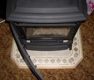

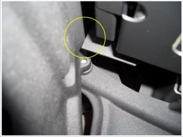

Below is a picture of my Castile with the front cast door open as far as it will go. I see no particular reason why it seems to be limited this way, but it would be much easier to clean if it could open more. My second post is another picture that shows where part of the cast door hits a small metal plate which is what is stopping it from opening further. A simple fix would be to cut a small corner of that metal plate off (about a 3/4").
Does anyone else who has the Castile free-standing stove also have a limited opening of their door? And does anyone see any harm in cutting that corner off to allow the door to open fully?
Thanks: Steve

Do the sides open? On my Santa fe I have to open the left side door before I can open the front up all the way.
No, the sides don't open.
Steve
Ditto to Rich, same stove, door opens all the way. I'll look tonight when I get home, hopefully one of the quad guys will chime in.
Email a user named "jtp10181", he works at a quad dealership and could probably answer your question quickly, he's been a big help to me (not that others haven't!). Makes me wonder if that tab is installed correctly, you may want to check the blow up diagram in the back of the manual?
Ok, just looked at my stove. That bracket is also on mine, but only restricts the door at about 100-110 degree opening or so. There is some hardware on that bracket, wonder if you can loosen things up and retighten and gain some space? Again, check out that explosion diagram in the manual to see what your dealing with. If you are thrifty, this stove is pretty straight forward to work on, I think I've basically taken my apart and put it back together again. Make sure your warranty is up, you have a local dealer, and a solid internet connection before you putz!
I have the Castille as well and my door opens all the way.....no restriction at all.
Thank you for all the replies.
I'll take a good look at her in the morning and reference the drawings in my owners manual. I'll see if I can either move the part out of the way or just cut that corner off. I was just concerned that it might not suppose to open all the way, but now I know it is.
Steve
The only time I ever get jam ups with the doors is when the glass door jams up the cast door. This happens at like 90 deg though. Definatly something going on here. Check with your dealer if you can;t figure it out.

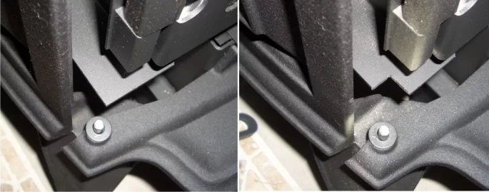

It was an easy fix. I lifted the cast iron top off the stove and that allowed me access to the top hinge of the cast iron door. I opened then lifted the door just enough to support its weight while I lifted the top hinge pin out, then lifted the door off of the bottom hinge pin.
I then used my Dremel tool to cut out the corner of the metal piece that was stopping the door from opening properly as you can see below. Now it opens all the way as it should.
Thanks again for all the replies/assistance!

Nice job short! I may follow your lead...
Good job.
I looked at my stove again and it appears that the piece you cut is shaped slightly different than the picture of yours before you cut it.
Looks like the factory didn't cut the part properly to begin with.
Hard to beat a Dremel.
