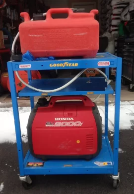

I suggest you skip the interlock system and put the money into an inverter generator. Just run extension cords from the generator to necessary devices......after all power interuptions aren't permanent...why bother with a permanent solution.
See my Honda Power Station below!
  • [Hearth.com] Quad Castile and generator question
