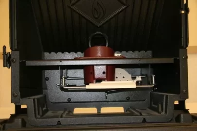

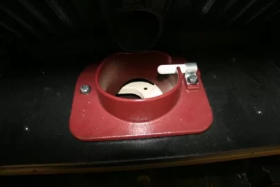

I’m not sure what you are referring to when you say about sealing up the sides where the floor meets the side of the stove, could you maybe explain this to me a little better? Thanks.
On the fire boxes floor where the fire pot attaches directly to the left and right of the fire pot where the 1/4 inch bolts, 7/16 head, are there is a 6 or so inch seam where the stoves side walls meet. I always had fly ash that was blowing from a couple of areas at these seams. I just cleaned up the stove real clean and used a Scotch Britte pad to remove the grime, wet the area with water and applied a bead of high temp 2100 degree black Rutland stove cement I got from Home Depot from the front of the baffle plate to the front of the floor where the door is. I let it set up for several hours and started with a slow burn. Just follow directions on the caulking tube the stuff comes in. How long this lasts is to be determined but so far so good. I could try to take a picture but the stove is running right now. I would have to clean the fly ash off the floor to get a picture, maybe over the weekend when it warms up. Also make sure the burn pot holes are clean, I use a drill bit to clean mine out.
wow shiney....was that taken while still new?
Not my stove but it was one of the many pictures I found online when the MT Vernon AE was just coming out. I never even saw or touched one before I ordered it but there was info and pictures like this out there if you knew where to look.

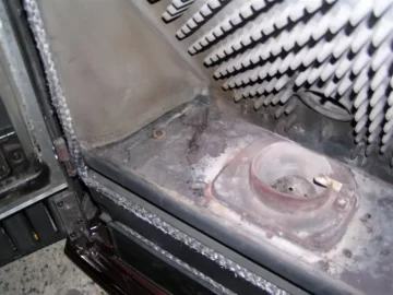

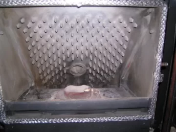

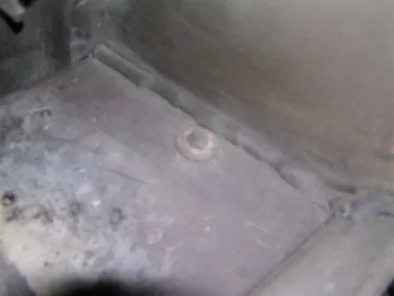

Pictures of what I sealed, floor to side wall of fire box. Hope this helps.

So doing this helped eliminate the clinkers as well as replacing the springs? I am still getting clinkers sticking to pot sides and not dumping, also unburned pellets in ash pan. I am trying corn setting tonight to try adding fewer pellets to pot, but I will have 20 minute igniter on times now. :coolgrin: Also does anybody now the size of the springs, length and diameter, i would like to buy someplace other than a quad dealer, to get them cheaper.
tsmith said:
FordMastertech said:
tsmith
FMT
It did help, I do get fluffy ash build up on the sides of the burn pot but it doesn't effect anything. I am using the auto setting, sunflower seeds and high elevation at this time so I think the fluff is from the lower burn rate on the auto setting as it gets closer to the thermostats set temperature. I never really liked the auto setting because it seemed to take to long to get the house up to temps I wanted. I am running it now with a 2 degree differential and a thermostat temp set at 71 the house is more comfortable due to the stove running longer at a lower setting. It also helps with the start ups and shut downs thus saving the igniter.
Keep messing with the settings but allow some time to see the results.
I can't remember where or what the springs were off of but I really didn't look around anywhere except my junk pails to find something that would work. As far as measurements you would have to remove one of the good ones to check it out, CRS syndrome happing here. The Quad springs weren't that expensive $12.00 set of 4.
