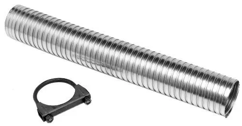

Have you checked at auto parts store for flex metal? Or googled it? You could also make an adaptor from metal pipe going from 2" to 3" I used 2" on the AE's oak. Can't remember if I found it at an auto parts store, or farm implement store. Only used a 2ft. pc., then finished with pvc pipe. kap
An auto part store will have the heavy duty flex piping...be sure you do not need to make a hard 90º angle, it's a wide arc to get there.
Auto part stores will also have adapters to decrease / increase connections. When I installed my OAK I pulled the exhaust port off of my Accentra FS, brought it to the store along with the Harman wall thimble accessory that incorporates the outside air and exhaust in one unit. Took a bit of time sitting cross-legged in front of the rack of parts, but eventually found a solution.

Flex pipe:
