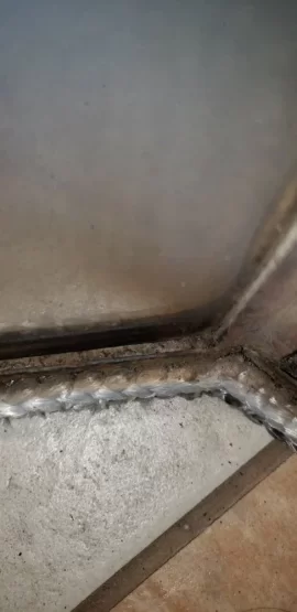

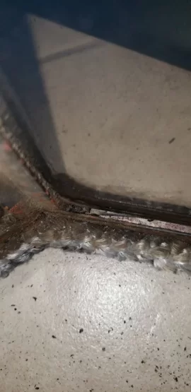

Here are some photos of where I'm talking about.
This is looking up, from the inside, st the gap between the glass and door. I believe there is supposed to be rope there but I don't see any...
Just confirmed by blowing through that air is coming through the seam.
I'm wondering if I can fill this gap with high temp caulk instead of fully removing the glass to re-rope?
  • [Hearth.com] Quadra Fire CB1200 - air intake location?
Did some digging and found the answer on this forum actually!
Apparently Quadra Fire has something called an "air wash" system - the gap there is on purpose and sucks in air to "wash" the glass with fresh air and keep it cleaner.
Going to stick with it. Thanks everyone.
