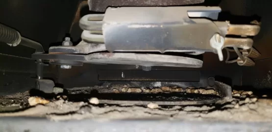

Hey guys. The clean out plate on my Quadra Fire Classic Bay 1200 seems to be loose. I can open and close it but it is hanging open and allows pellets to fall through, and also hams jams up.
Any idea on how to fix this?
Here's a photo from below through the access panel. Thanks!

Are ALL fasteners tight?
Hey Daksy, thanks for the response.
I ended up fixing this. First off, the lower plate's hinge bolt was missing a nut on the other side, in the ash pan... so the plate was kind of loose, though that wasn't my main issue! I found a matching bolt in my tool box, and a washer, and installed that.
Then I tried to squeeze my hands into there and tighten up the bolt/nut that holds the main clean out plate (top plate). Ended up making it too tight LOL and loosened it back up. Put some thread locker blue on there as well to hopefully hold this. I then used silicone spray to lubricate the moving pieces and rod assembly. Moves perfectly now, and plates are pretty tight. Fire was much easier to get going this time around.
