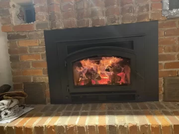

Last week we had our Quadra fire Expedition II insert installed after I cut out the old heatform.

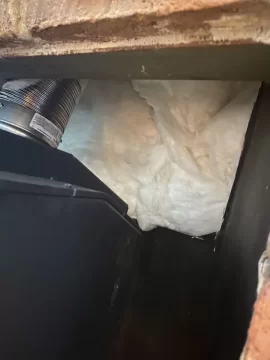

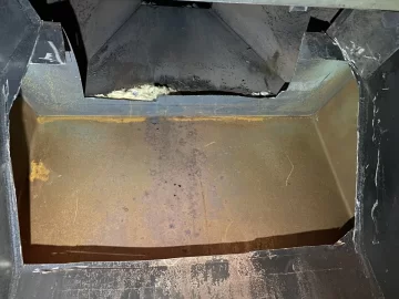

They installed a 6" flex liner, and stuffed insulation around it (see picture). I'm not sure what type of insulation this is, but I assume that they know what they're doing and that it's fine? Just wanted to double check here. They did not install a blockoff plate.

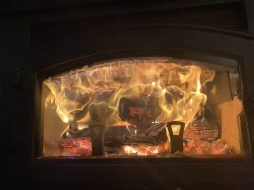

The insert burns really well, as you can see, and throws off a decent amount of heat. I was hoping to heat my house with just the insert, but that won't happen. Last night we had our first freeze, and while the living room is probably around 73, it can't keep the rest of the house warm. Oh well, it is what it is. The fans on it work OK, they're loud for the amount of air they move.

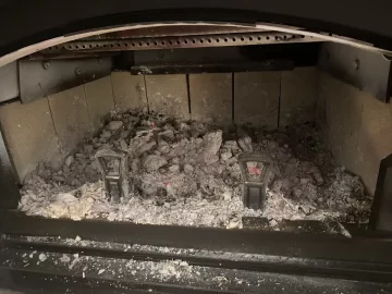

Lastly, after burning a full day and stuffing it at night, I have SO MANY coals. They'll all be ashed over when I get up, but when I stir around its just inches and inches thick of coals. I can stir them around and it'll be really hot, but even after several hours of stirring I'm still left with what's in the picture. I ended up shoveling them out into a steel bucket. Any way I can prevent this from happening? Yes I could wait longer to refill it, but then my furnace is constantly running, which I'm trying to avoid. All help is appreciated!

I cant speak on the insulation as I have a free standing stove and wall thimble. But if you're burning good hardwood like oak and hickory, the coaling is just part of it. In my BK I usually pull the coals to the front/ center since it burns front to back, then lay one split east/west in the back to level it up and stack the rest of the splits north/ south till its full. Ive found this best to use the available coals while still getting a full reload.

I too will always wake up each morning to a stove full of coals, this is after loading for the night with hardwoods. Since I don't have time to babysit it all morning, I simply rake the coals forward and load as much as I can on and around the coals. Usually this will end up being a good 5-7 pieces of wood of various sizes, more than enough for the day time burn till I get home. When I get home from work, I just turn the air up on my stove and rake the coals around and let the hot coal bed burn for a few hrs till the evening reload. This will get my stove top temps back up over 300-400 degrees assuming they dipped below that at some point during the day burn (or night burn).

I own the same stove branded to vermont casting. The coaling in your picture is normal; Just rake them flat and reload on top of the coal bed. If the amount of coal is too few for a quick reload and you really want to reload, you can shovel them to one side next to the firebrick (the stove is pretty wide), and load new wood on the cold side, then do a top down start on your fresh load.

Your flame looks great and your tube looks fine. However the gasket on the glass seems to be bulging out a little near the door latch?

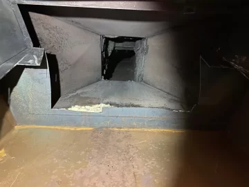

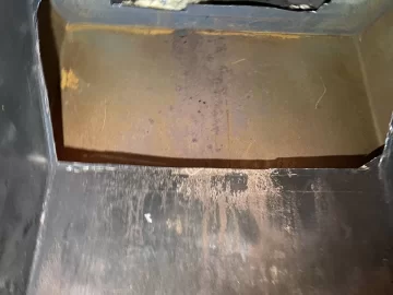

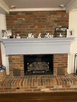

I forgot to post some before and after pics and how I cut out the heat form insert

Your pictures don't show, did the installer add a block off plate at all? It would seem like you are potentially losing heat up the chimney instead of it being projected out into the room.
No he didnt... they stuffed a lot of insulation up there though. It wasn't until after I ordered the insert that I learned about a block off plate. I'm hoping that with all the insulation up there the heat loss isn't too significant
