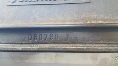

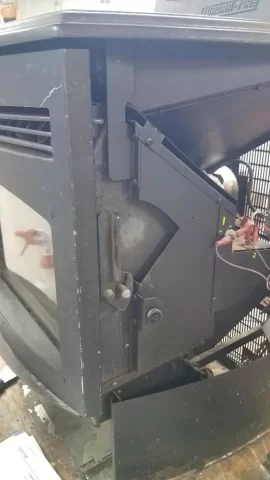

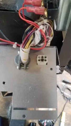

Howdy all, just signed in to what appears to be a great forum. Just picked up a used 2005 quad and need to know if there is an "on off" switch that plugs into the bottom of the control panel. Trying to get this one going. I have power going to 2 pins on the control box but no lights and no fire, so I started looking around and found the plug on the bottom for what looks like a switch, one of the female inserts looked like it got shorted out... any help would help....Mike
Pics would be great
I should have known better... Here's a few of the female plug, the hinge style if that is needed for identification and the code with date...
  • [Hearth.com] Quadra fire Sante fe 2005
