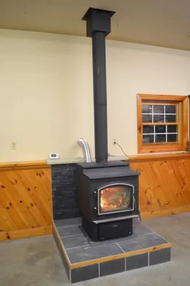

Hey guys,
First, thanks for bringing this to my attention Jetsam, this is a post I was thinking of adding awhile back, then I thought maybe I'd wait until I used the stove more, but perhaps you guys might be able to lend a hand with a problem I was having...so please, consider this an "ongoing review" for now...
After having this stove installed last winter. I used it only 7-8 times. I'm still undecided as to whether or not it was a good purchase. I'll take that back the day I get those 12-18 hour burns you guys are talking about! At the moment I'll stay disappointed just because I hate having to mess with stuff like this. There is a learning curve to every stove you'll ever use, but as for "smartest stove you'll ever use", I haven't seen that part yet. Thought I'd share with you my limited experiences with this so far. I'm actually thinking the problem is in the electronics somewhere?...there's clearly comething going on to my way of thinking, and within the next couple weeks I'll get after my dealer to take care of it.
Stove does throw a tremendous amount of heat, seems like it will be way plenty enough to heat my shop, though I haven't used it in any extreme temps yet. Was usually around 15-20 degree's when using last spring. My problem is how to get the fire under control. At least a half dozen times I was able to spend several hours building a nice hot red bed of coals. Once a hotbed of coals was established, I'd push the button, load the stove up, and let it go but keeping a close eye on it. When doing this, I always made sure the shop temps were below what the thermostat was calling for. All I could get the stove to do was burn all out and I wasn't trying for that, i'm looking for that nice even all night 20 hour advertised burn. At 20 degree's outside It would quite easily cruise past the temps I had programmed into the thermostat. The only way I could get it to temper itself and shut the air down was to do it manually. And therein lies the problem.
No matter what I tryed, the red light stays off and the stove still called for heat. If I set the thermostat at 65 or whatever I set it at, the stove would cruise right on past that and burn all out up to 70-75-80 etc. Within a few hours the entire contents of the stove would be burnt up, not just to coals but to ash. I always kept careful watch that there was no overfire, this stove does seem to do a good job of staying cool all around it.
There was a couple days where after it cruised past the set temp by 10-15 degree's I pulled the pin and shut the air down manually and immediately you could see the secondary's kick in and act as it should. So bottom line, the stove wasn't recognizing that the called for temperature had been reached.
The dealer I purchased this from has a place along the Mississippi River and last spring he had an awful lot of terrible flooding to deal with. I have no doubt he's still dealing with the aftermath of that. He's a great guy so I'm not worried, he'll get me straightened out, and I'm looking forward to that.
That's it for now, I see a few posts where others have dealt with this sort of thing, chime in guys, would love to hear what you did to get it all figured out.

I figured it was high time for an update here. Been a lot colder up here in northern IL than usual so plenty of time to use the stove. When I was using it last spring, it would cruise through a full load of wood in 3-4 hours and you couldn't slow the stove down for nothing.
I took the time to go to my dealer a couple wks back (who I consider to be exceptional). He offered to come out immediately, but before I let him do that, we called support at Quadra-Fire. Super nice gentleman! He said check it out, make sure no wires crossed etc, and if all was hooked up right, almost had to be the motherboard. My dealer is 45 minutes away, and I didn't want to cost him the trip, so the tech sent us a troubleshooting tip sheet. I ended up going home and just took a look at the wiring. All was hooked up perfectly. BUT...I wiggled each connection, and part of the problem solved itself as I heard the air control open soon as I did that. Seems a loose wire connection was at least a part of the problem.
Been burning steady the last two weeks, and there is still a little problem, but I like what I see so far. Like tonight, set thermostat for 70 degree's, loaded 1 1/2 hrs ago, just checked, garage is 81 degree's, air is closed down all but about a third. But it shouldn't be calling for heat, so it should be shut down completely. Green light still on, so the electronics are still calling for heat, at least in a small way, and it shouldn't be calling for any heat at all, so right at the moment I'm in "wasting wood mode". No where near over-firing though, this stove now seems to do a real good job towards that end.
So because of this, it burns the wood too quick, though I have to tell you, even with the small problem, I do like what I see. I do expect it will shut the air off completely and drag the time of the burn out by at least a few hours. Not quite ready to say I wish I hadn't bought the one with the electronics just yet, I don't give up easy :) If we can get the electronics figured out, I'm thinking burn times are going to increase 3-4 fold! I'm not giving up till I hit that 20 hour threshold I was promised...and I think that is attainable if the stove learns to control the air better.
One observation, this stove throws heat like crazy! Coldest it has been is 17-18 degree's so far, so this isn't exactly the best test, but even that night, it kept my garage above 70 all night long. That's heating 1500 sq ft of garage, 10 foot ceilings, and three 7X12 overhead doors. I consider this an ongoing review, be back when I have more news....hopefully the good kind.

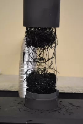

Also a friendly service reminder for you guys... Only used this stove 6-8 times last spring. This year, I started my first fire without checking, but when it wasn't lighting/burning real well, I shut it down and removed the contents of the stove. I also wanted to see how that section of chimney worked that slides up and down, and I certainly wasn't expecting to find anything, and i ended up cleaning 5 foot of birds nests out of the chimney! Bottom foot was pure black from the smoke that backed up. 3 different birds nests actually....little buggers must of worked all summer hard as they could. So don't do what I did, check your chimneys before starting your fire!
[Hearth.com] Quadra-Fire Stoves-similar but different models...
Ironically enough, on my house chimney, I've never had a bird nest (knock on wood), but on this one i had 5 foot of it!
