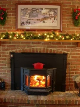

This is our first season with our new wood stove and we love it! However, i feel like i'm still making the transition from fireplace to wood stove,
so i have a few basic questions. (Don't laugh too hard!) Are metal sounding creaks and pops normal? I'm unsure how much wood to put in the box;
load it up or a couple of logs at a time? (actually, i'm very tentative about putting too much wood in. I think i'm afraid the whole thing's gonna blow! haha)
I've tried both ways and even with the air flow cut way back, i seem to be reloading every hour or so. This just
doesn't seem right. (it's all seasoned oak wood) Does laying the wood east/west or north/south make a difference? Should i let it get down to coals and then reload?
I have read the instruction manual thoroughly but it really doesn't give as much detail as i would like. There are so many of you that know what you're doing!
Thanks for your input!!! I really appreciate it!
p.s. I had a previous post about the height of our mantle. After consulting a local mantle guy we decided to keep our existing one. He said we should just keep an eye on it and feel how warm it gets. We've been doing that and it seems to be fine. Yeah!
