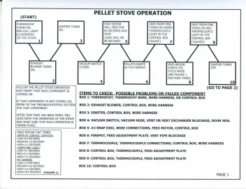

By spinning the fan, did it then jump right up to full speed? The igniter should not have gotten hot unless the exhaust blower was on. Now perhaps it was stuck or has a bad winding? View attachment 138345
We don't have any of the stupid laws that you are talking about, here in this part of Maine. We had our dealer install the stove and just so long as the installation instructions were followed, we can put it ay where we want.
But back to the problem, the igniter was getting hot (not hot enough to get a flame)before I spun the fan. Yes, the fan went up to full speed when I spun it. I was just checking to see if it was frozen, so I didn't use a lot of force. The stove didn't start right up after the fan started. I took out the auger and moved it by hand until I was satisfied that it was moving freely. It did move pretty hard at first. After seeing the trouble shooting diagram, I have to think that the auger motor was stuck.After I put it back in, the stove started after I got a flame.
