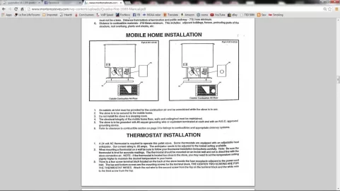

Since we are dealing with 24 volts, I did some searching and here is part of the 1200 manual saying to turn the anticipator all the way DOWN, NOT UP!
Live and learn! Since you've been running it for years, it sounds like your thermostat took a dump.
I am not sure that the 1200 uses a 24 volt t stat it looks like the manual you have up is 1000 it is an old stove but could be wrong if memory is still good and you take a reading on the t-stat you should see 3 volt not 24
so now I should turn it to the lowest,so the theory of a higher swing does not apply?
You definitely want a higher 'swing', which is the amount of degrees that the thermostat will wait before it turns the stove on or off. DBCooper said his stove was 24 volt, hence I copied the old page out of a manual for a stove that has 24 volts. The anticipator is supposed to be set for the actual current flowing through the system but most of us don't have the capability of measuring that.
Basically, first set the anticipator at the same # that worked for you for years and see if that works. Then if it doesn't set it at .05, which is what the current is according to the page I copied. If it still doesn't work, then go to the other extreme and set it at the highest setting. If it STILL doesn't work, then throw that POS mechanical thing in the trash and get a thermostat that allows you to set the swing! Oh, STOVEGUY, that was for a 1000, so your memory is still a heck of a lot better than mine!
