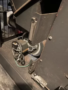

I like the easy of servicing the magnetic latch side doors have. Unfortunately the older CB1200s have the side mounted magnets mounted in a plastic case the clips into the metal brackets. The plastic clips break and the plastic melts and warps from the heat! Fortunately there is an update kit. It is called:

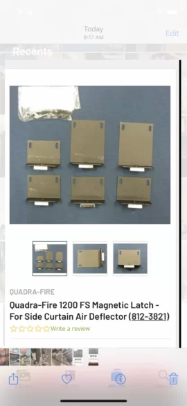

Quadra-Fire 1200 FS Magnetic Latch - For side curtain air deflector # 812-3821

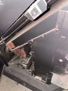

These new magnetic latches have the magnets surface mounted with no plastic to melt or break! :-)
Now the doors stay closed!

Pic 1-2 - Shows old latches
Pic 3 - Updated magnet latch kit
Pic 4 - Updated magnetic latches
